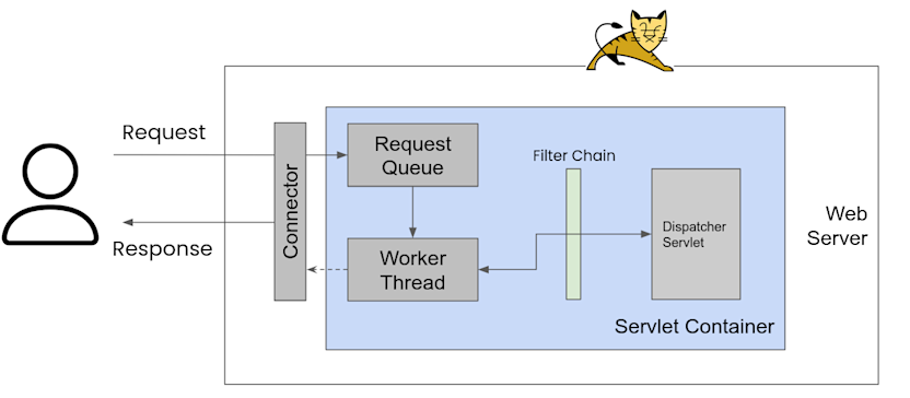

We managed to launch a successful request to our simple servlet implementation. But what happens before our filters and the servlet is invoked? Here's a high-level overview.
  • Connector: The connector deals with everything related to the HTTP protocol for newly accepted connections and manages them throughout their lifetime. It identifies the servlet container to forward the request and processes its response. The connector enables Tomcat to act as a standalone web server.
  • Servlet Container: Once the request is forwarded to a matching servlet container it is put into a request queue waiting to be picked up by a worker thread. If currently all worker threads are busy the queue will fill up.
  • Worker Thread: Once a request is picked by a worker thread it will start processing by going through the filter chain which finally ends up calling your servlet.
