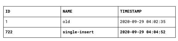

7. When the single insert finishes and commits and the batch insert is still running the resulting table will only have the single insert visible. The entries of the batch insert will only be visible after the complete transaction finishes and is committed.
Assume we are extracting at this point in time from the table and load the latest timestamp 2020-09-29 04:04:52 into the cache.

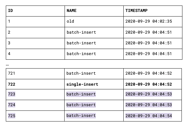

8. When the batch insert then finishes, the resulting table will look like the one below. Clearly visible is that the database calculates the timestamp mid-transaction, not on commit.
Assume we are extracting again, filtering on “timestamp > MAX(timestamp)”, whereby the cached maximum timestamp is 2020-09-29 04:04:52. We will only extract the rows highlighted in purple. The rows with ID 2 to 721 will not be extracted because their timestamp is less than what was received in the first delta load.
