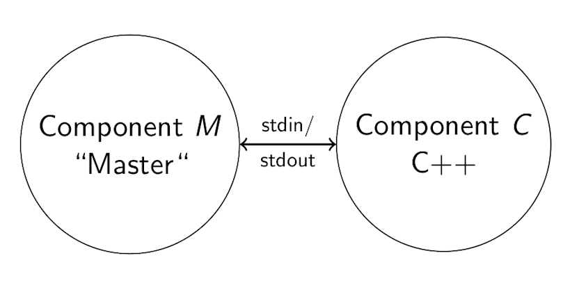

As part of our internal in-memory database SaolaDB, we have the following setup: There is a management component M, which is responsible for starting and orchestrating instances of component C. M communicates with C using stdin/stdout.

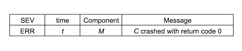

At some point, our monitoring reported the following for one instance of M and C:
So, component M reported that component C crashed (i.e., unexpectedly stopped operating from M's perspective); but with exit status 0, which normally does not mean any failure. (Expected failure exit statuses would be any non-zero value.)

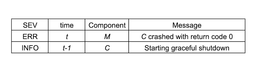

Looking back in the log, we found another log message, so the related log messages essentially read like this:
So, before component C exited with return code 0, it logged that it would start a graceful shutdown. This is in line with the return code 0, but then, why is component M reporting this as a crash?

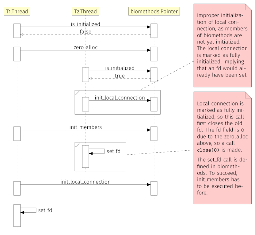

It took some time to understand what exactly needs to happen to end up with a call to close(0), but it was soon clear that the main problem was a race condition.
The Race Condition

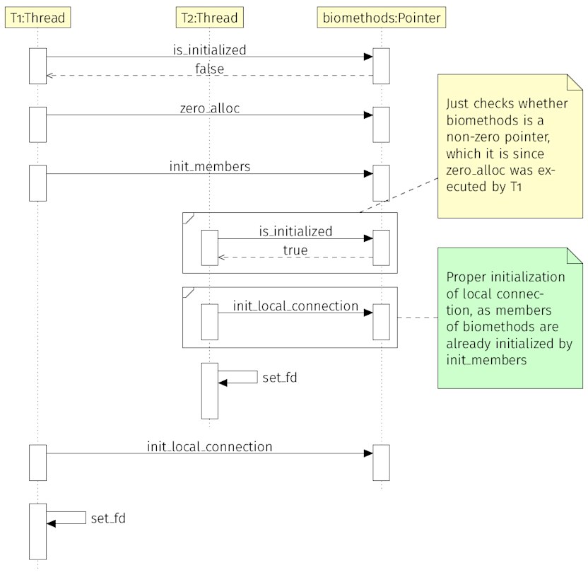

The Race Condition essentially consists of four blocks which need to be executed in the right sequence by two threads.
  1. If a global pointer is zero (=non-initialized), a struct is zero-allocated and assigned to the global pointer. This is code in libpq. (is_initialized + zero_alloc in figures below)
  2. The structure is initialized (by the thread that allocated it). The fields in this structure are function pointers. This is still code in libpq. (init_members)
  3. A connection/thread specific structure T is initialized, with reference to the global pointer. If the function pointers above are not yet initialized (i.e., other thread executed block 1 but not block 2), T is marked as fully initialized. The initialization code is in libcrypto, but of course initiated from libpq. (init_local_connection)
  4. A “set file descriptor” call for T is attempted. This requires that function pointers above are initialized, so the other thread now has to have executed block 2. However, if T is marked as already fully initialized, the “old” file-descriptor is closed. Since there was no file descriptor set before, the value of this field is still 0 at the point, causing a close(0) call. Again, this is code in libcrypto, but called by libpq. set_fd
Note that block 1 is in itself already racy as it might cause multiple allocations of the struct to be assigned to the global pointer. Additionally, note that if blocks 1 and 2 were one atomic block, the whole issue disappeared.
